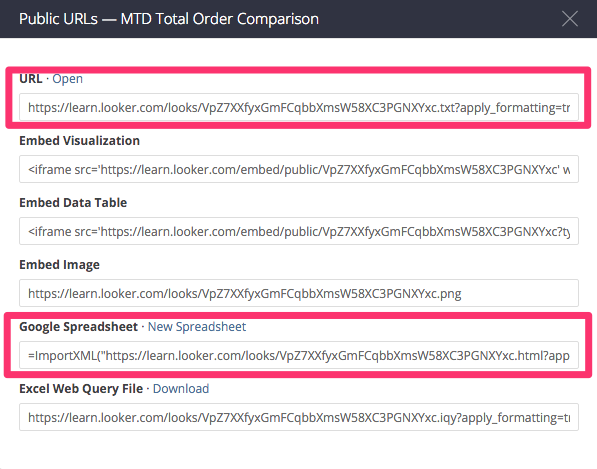

  1. Make sure the look is public.

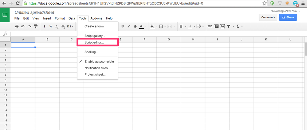

  2. Head to Tools > Script Editor from the top section of the sheet.
  3. Paste the code from the script at the end of this post into the script editor and save - you may give it whatever name you’d like. Close the script editor and refresh the Google Sheet.

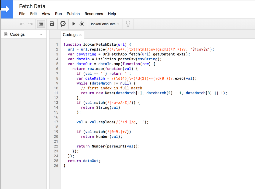

function lookerFetchData(url) {
  url = url.replace(/(\/\w+\.)txt|html|csv|gsxml(\?.*)?/, "$1csv$2");
  var csvString = UrlFetchApp.fetch(url).getContentText();
  var dataIn = Utilities.parseCsv(csvString);
  var dataOut = dataIn.map(function(row) {
    return row.map(function(val) {
      if (val == '') return '';
      var dateMatch = /(\d{4})\-(\d{2})-*(\d{0,})/.exec(val);
      while (dateMatch != null) {
        // first index is full match
        return new Date(dateMatch[1], dateMatch[2] - 1, dateMatch[3] || 1);
      if (val.match(/[-a-zA-Z]/)) {
        return String(val)
      val = val.replace(/[^\d.]/g, '');
      if (val.match(/[0-9.]+/))
        return Number(val);
      return Number(parseInt(val));
  return dataOut;

Below is an example of our function on a Google Sheet, using a public url from learn.looker.com:
=lookerFetchData("https://learn.looker.com/looks/VpZ7XXfyxGmFCqbbXmsW58XC3PGNXYxc.txt?apply_formatting=true")
How to alter existing ImportXML links
In order to change your existing sheets all you need to do is change the function, for example:
=ImportXML("https://learn.looker.com/looks/VpZ7XXfyxGmFCqbbXmsW58XC3PGNXYxc.html?apply_formatting=true", "//tr")
Becomes
=lookerFetchData("https://learn.looker.com/looks/VpZ7XXfyxGmFCqbbXmsW58XC3PGNXYxc.html?apply_formatting=true")

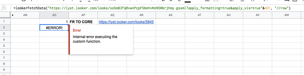

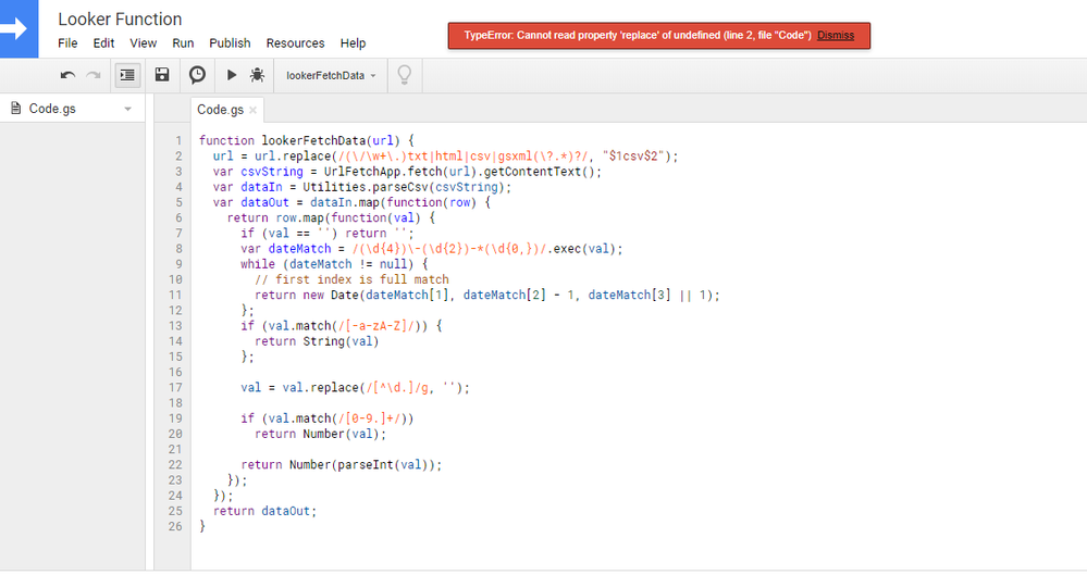

I have this script successfully in two other spreadsheets using two different time-driven triggers for the refresh. However, I am using this script once more to import data every hour from two looks (two sheets obviously), and they keep erroring out! The only thing different about this scenario than the other two is that it’s one spreadsheet with two sheets, while the others are just one.
When trying to manually run my script, I get this error:
TypeError: Cannot call method "replace" of undefined. (line 2, file "fetchdata")
Timeout is also in my logs
Again, I’ve copy/pasted directly from both this site, as well as my original scripts to make sure there are absolutely no differences. I’ve tried busting cache as well. Here they are currently (the currently work, but if I check back in 20 minutes, they won’t work):
=lookerFetchData("https://barkandco.looker.com/looks/[redacted].txt?apply_formatting=true&apply_vis=true&refresh=1508430768885")
=lookerFetchData("https://barkandco.looker.com/looks/[redacted].txt?apply_formatting=true&apply_vis=true&refresh=1508430718598")
I have a feeling the problem is not within my script, but with the looks themselves, I just don’t know what that is.
Hey @Miranda_Short! I’m wondering if this is related to an issue that we are seeing with measures of type list. In these Looks, do you have any measures that are list aggregates and show up in the LookML with type: list defined?
This may be an issue best resolved by emailing us at help.looker.com, or by opening up the in-app chat, if you’re a developer.
From what I can see, none of the measures are defined as type: list. With that said, do you suggest still reaching out to support?
@Miranda_Short yeah I’d say that’s the best path forward. It doesn’t appear to be related to the same issue and it’d be best to get you some individualized attention. That way we can log in to the instance and see what is going on for ourselves

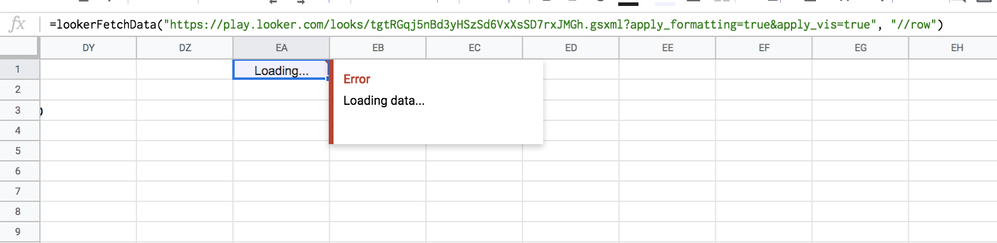

I am having trouble running any report with the lookerfetchdata - I always get error loading data forever, could anyone advise?
I wonder if it’s a problem with your script, or a problem with your Look— The best way to figure that out is to try an example look!
If you try =lookerFetchData("https://play.looker.com/looks/tgtRGqj5nBd3yHSzSd6VxXsSD7rxJMGh.gsxml?apply_formatting=true&apply_vis=true", "//row") does that work, or throw a similar error? That’s an example Look that I just made public and verified works on my end.
Hi Izzy, thanks for your response. I’m still getting the same error (see pic)
Hmm well in that case, the problem must lie in the script somewhere. Did you copy and paste from the original post in this thread?
yes, here it is
in fact, the report is now working although is still very slow. In some cases I am now getting a new error message, any idea how to proceed?
Ah, interesting— If it’s a super big report, then it makes sense it would be taking a long time to load and look “errored”. Additionally, if the report is too big, there’ll be an internal error thrown by google sheets, usually because of a timeout on their end.
Google Scripts enforce a 30s timeout, I think, so if the query takes longer than that, you may want to add row limits or filter it down to make it smaller.
        return String(val)
        return Number(val);
  return dataOut;
The key change being
to
var dateMatch = /(\d[^a-z]{4})\-(\d{2})-*(\d{0,})$/.exec(val);
Regex is genuinely mystical to me so this might be anything but perfect, but it works!

I’m getting this error:
Any ideias on how to solve it?
I also get the same error as above! If there could be an update that would be greatly appreciated!
Hey gang, I believe this one is not currently supported anymore.
You may want to check out the new Google Sheets action: https://help.looker.com/hc/en-us/articles/360044002214
If that doesn’t fit your use case, drop a note here and we can troubleshoot this appscript code together 🙂
