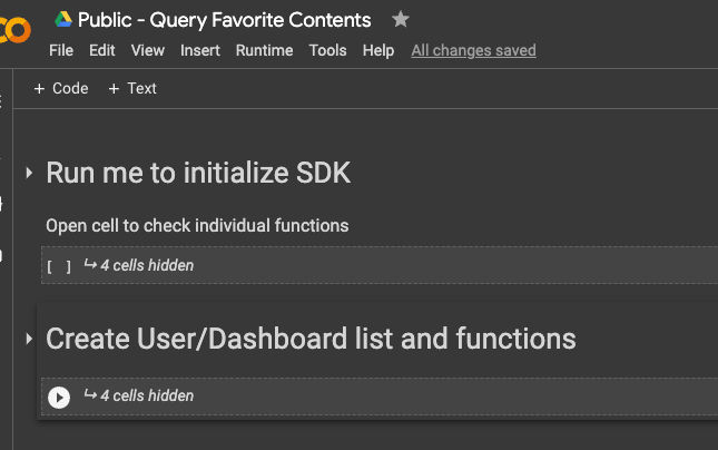

Below I will detail the methods with picture, but because pictures are big, they are hidden by default. You can click on the button below to show them.
I HIGHLY RECOMMEND COPYING THE ENVIRONMENT TO YOUR OWN gDRIVE. HOWEVER, ANYTHING YOU WRITE IN THE NOTEBOOK IS NOT ACCESSIBLE BY ANY OTHER USER.
First, there are two main phases to creating the environment, the first on is getting the SDK Initialization working, and the second is to get the code functional.
Colab Summary

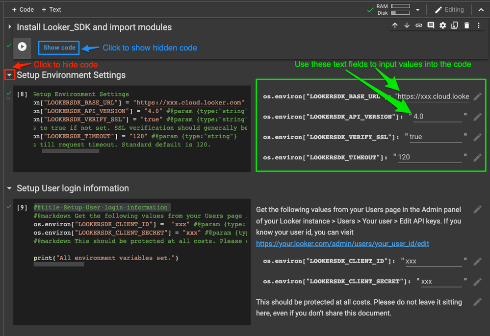

If we open up the “Run me to initialize SDK” section, we can see there are a few code snippets broken up. In shared Colab environment, I have added the parameters we need to adjust on the right-hand side to make them easy to setup.
The code is a little updated from the displayed code below, but is functionally the same.
After you have each of the form fields to your specifications (NOTE: you really only need to change the base_url, client_id and client_secret), we can get to the SDK calling.

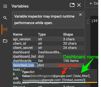

    If everything works out, you should see a printed list, and you can open the variables tab to see the full list of users.

    Having said that, you can test that it is working correctly, by stopping at any time, or during the process you can check the favorited_contents dictionary in the variables view.
