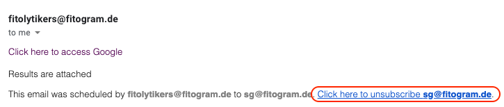

Does it allow us to modify the unsubscribe link in the email? Looker email provides a link to unsubscribe from the schedule. However, we would like to add our own link or modify this link to navigate to our own webpage to handle the subscription. Is there a way to do so using this integration?
