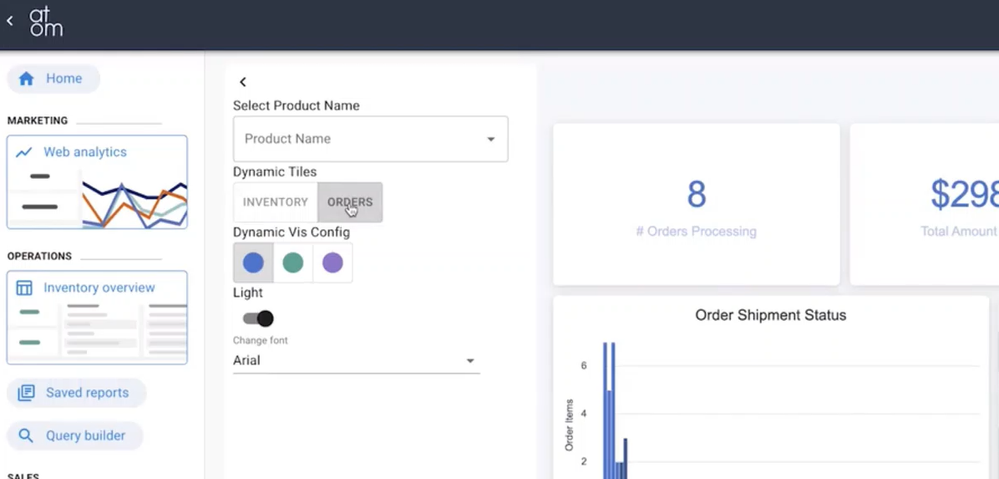

@luka_google I’m looking for swapping tiles in particular. Daniel Massarsky demoed this in JOIN, and I would love to learn how to do this!! He called it “Dynamic Tiles” and whether or not it’s actually loading new tiles, modifying the dashboard definition on the fly, or simply hiding/showing tiles what I’m craving is the net gain of not having to reload the whole dashboard iFrame to respond to user selections in the app.

@la5rocks ah I see, appreciate the additional context. The screenshot you had shared there looks like the atom fashion demo embed portal. The dynamic tile swatch from that demo to my understanding relies on javascript embed events and our embed sdk which we can use to manipulate the iframe to do things like swap the viz config, color theme, dashboard layout all without modifying the stored dashboard definition.
This is most straightforward when using our embed sdk (https://github.com/looker-open-source/embed-sdk), specifically there is a .then() callback method that we can pass a function to store the state of the current dashboard (tile layout, viz configs, filters, themes, etc.) which we can then programmatically update from the client without having to make permanent api calls that will change the stored definition.
The example I shared has an overview in the EmbedDashboard.tsx file of this (for color and viz swapping, not specifically tile swapping but if you log out the dashboard object it should give you an idea of how to manipulate other parts of the dashboard) using the embed sdk. Where we pass a method to stored the dashboard state into the .then() callback → then use the embed sdk’s built in setOptions() helper method to post whatever change we want to make to the dashboard to the iFrame. Hope this helps!
