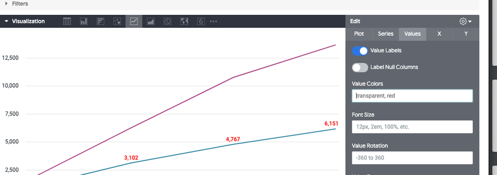

  • In Values menu, turn on value labels. If Value Labels for other fields are not desired, in value colors input "transparent, red" (can be any color)
  • Voila!

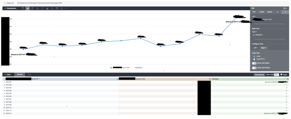

Hi @jamesnestler,
First of all thanks for the solution, is quite clever 🙂
However, I am following your steps, but I cannot reach the same output.
I have created same quick calculation (default formatting):
if(row()=1 OR row()=max(offset_list(row(),0,count(${XXX.XXX_month}))),concat("Amount at ", to_string(${XXX.XXX_month}), ": ", to_string(${XXX.XXX_number})),null)
Then I follow the steps on column chart:
  • Select column chart for vis type
  • In Series > Customizations, make the primary measure a line and change the color of the table calc to white:

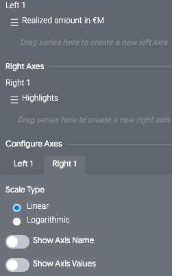

  • In Y menu settings, drag the table calc from 1 into the right Y axis, select the second y axis and turn off show axis name and show axis values:
  • In Values menu, turn on value labels. If Value Labels for other fields are not desired, in value colors input "transparent, red" (can be any color): here I have the problem. If a turn on value labels both labels from the primary measure and from the calculations appear, so the result is something like that:
    If I change the color of the label to red or transparent all labels change, the one from the dimensions and from the calculated dimension.
Am I missing something? Could you help me with that?
Thanks in advance
Nadirfb what you’d want to be doing is this
thank you very much @jamesnestler ,
It works, and it will help me a lot
