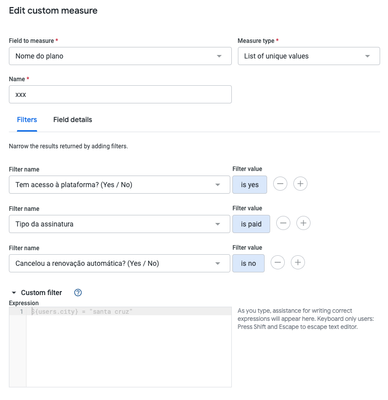

When I try to create a custom measure based on a string with the measure type "List of unique values" and I try to set filters, I get the following error:
Show More
A LookML model issue prevented this query from running.
Cannot filter on custom measure "xxx" based on a measure of non-aggregate type "string"
If I only change the measure type to "Count distinct", then it works. Also, when I use the "List of unique values" type, and I transform the filters to be custom filters, then it works.
Has anyone experienced this problem?

Hi, @sam8 ! Thanks for your response! Actually I am using an aggregate measure as far as I know. Isn't the "List of unique values" an aggregation over values?
The problem is that this does not work and raises the error pointed out above:
But if I try to do the same thing using the Custom filter, it works:
Both images above were expected to generate the same result in my opinion.

In your second image, where you don't see an image, do you see the SQL actually insert the filters? It seems to me like it shouldn't be working in either case.
Hi, @sam8 !
This is how the field gets compiled:
    STRING_AGG(DISTINCT CAST(CASE WHEN ( subscriptions.bl_has_platform_access   AND ( subscriptions.nm_type   = 'paid')) AND (NOT (( COALESCE(subscriptions.dt_canceled_at < subscriptions.dt_expires_in OR subscriptions.nm_canceled_by_email IS NOT NULL, FALSE)  ))) THEN subscriptions.nm_plan_label ELSE NULL END AS STRING), '|RECORD|') AS xxx
