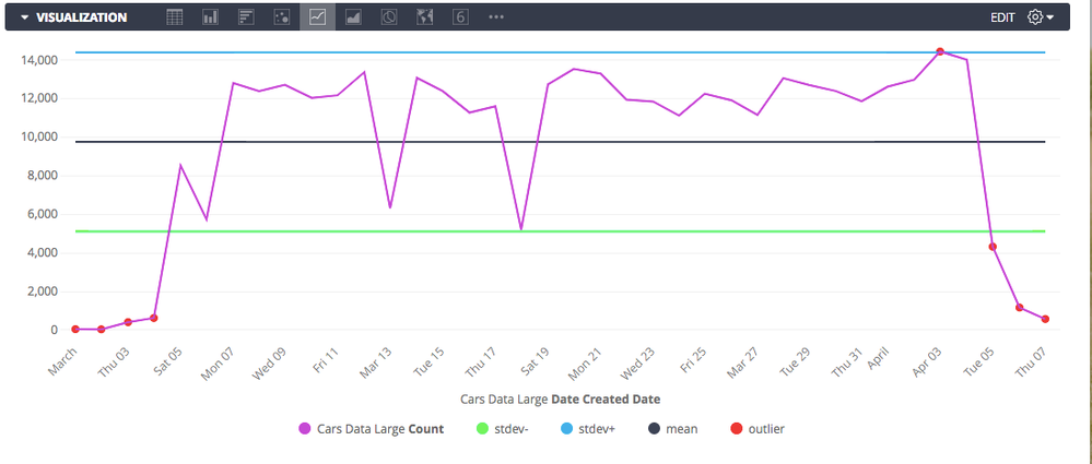

Hey @Tomas2,
I was thinking over your issue here and I think I was able to achieve something similar. Please note that the solution might vary based on the actual data.
My calculations were based on created date dimension & simple count measure.
These are the 4 calculations I have defined to calculate mean, -stddev, +stddev & the outlirers in my case I defined outliers which are outside 1 standard deviation of the mean values.
The last pease that has to be added if I understood your requirement correct is set a period of dates you want to calculate this over. I think you can achieve this with match advanced filters something like 14 days ago for 14 days should work. I did not have constantly added dates so i did not had this filter added. If you would like to get more information on Looker filter expressions you can find it here
