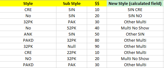

I am trying to create a calculated filed based on an if statement to categorize and add the sales in Looker. I have tried using multiple if statements but I am not able to figure out. I am not even sure if its possible in calculated field. Below is the data:
I need to create a calculated field to categorize the above styles and sub styles in a new column. My output should look like below:
0 4 47.9K

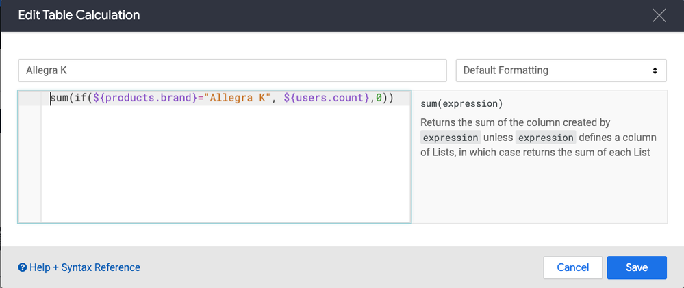

This is possible to do just with table calculations, but it would involve quite a few steps. I wrote out a similar example on my instance. First, I used an if statement to create a new column for the total of each cohort we want to show. In my example, I wanted total by brand.
** The overall goal of this was to aggregate count of users by a limited number of brands.
I did have to create a new table calculation for each brand I wanted to show.

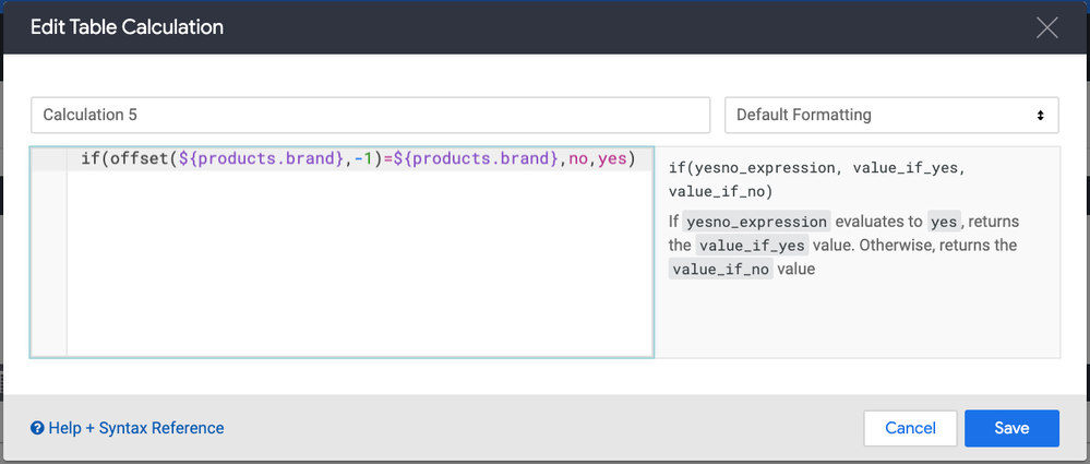

Then, I wanted to show only one line item per brand, so I sorted the data tab by the brand name and used the offset function with an if statement to determined if the line item above had the same brand name. If it did I returned no, else I returned yes. Then, I clicked hide no’s from visualization.

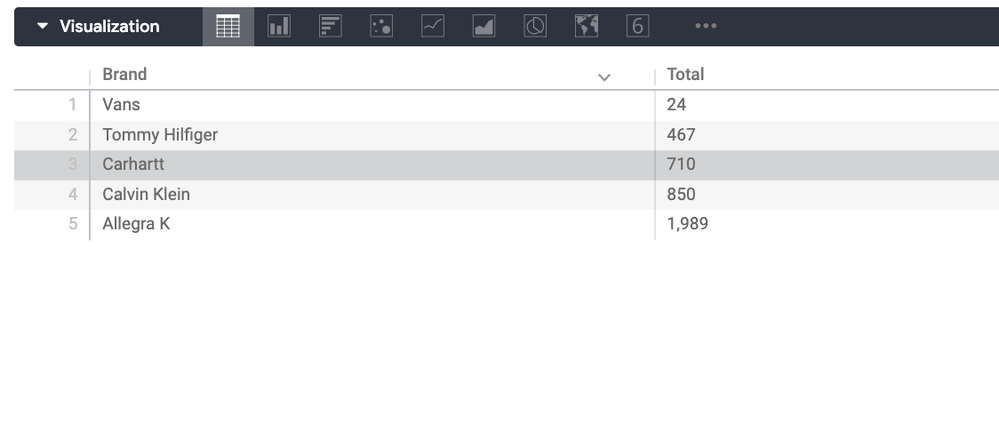

This was my end result below!
