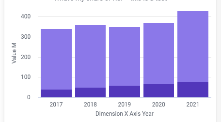

Our (stacked) bar chart currently looks like this:
But I’d like to give it a more clean look, like this for example:

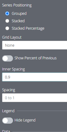

Hi @mathias_luyten
Use Spacing and  Inner Spacing  settings of the visualisation
This is 0.6
Vs 0.9
It will depend on how many bars you have of course
Hi @mathias_luyten
This is 0.6
Vs 0.9
Aha! This is called column_group_spacing_ratio in the LookML right? Thanks, that works out just fine 😄
