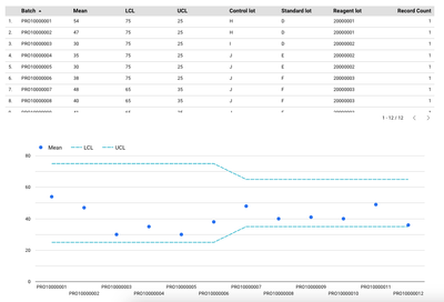

Hello, I'm working on a control chart and using the combo chart platform.  I've been able to plot results versus the upper and lower limits.  Now, I'd like to add some additional classifying information to the datapoints.  Specifically, would like to include, if possible, the information in the "Control Lot", "Reagent Lot", or "Standard Lot" columns in the plot.  Is it possible to visualize this information paired with the data points by changing the color/shape/some other way of changing appearance of each data point?  Or if not, can the data be visualized when hovering over the data point?
I will compare this to something I know: JMP.  What I'm looking for here is something like the "Overlay" feature in the "Graph Builder" platfom
