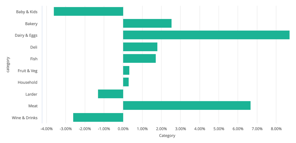

Great post here. I wanted to ask what’s the best way to format the bar chart according to value. I’d like to display negative values in red and positive in green.
Any ideas? Thanks
Check out @brecht’s comment here:
You could potentially use the pattern below, if you don’t have too many buckets. Imagine I’m looking at user count per state and I want to break out states with 300+ users. Select the dimension & measure and run the query. Now, create two (or more) table calculations: if(${users.count} >= 300, ${users.count}, null) and: if(${users.count} < 300, ${users.count}, null) Hide the original measure, and go into viz settings and stack them. This will remove the extra whitespace between the two tab…
The table calcs there ought to work great for this.
JakubD
Thanks a lot Izzy 🙂 It worked like magic!
