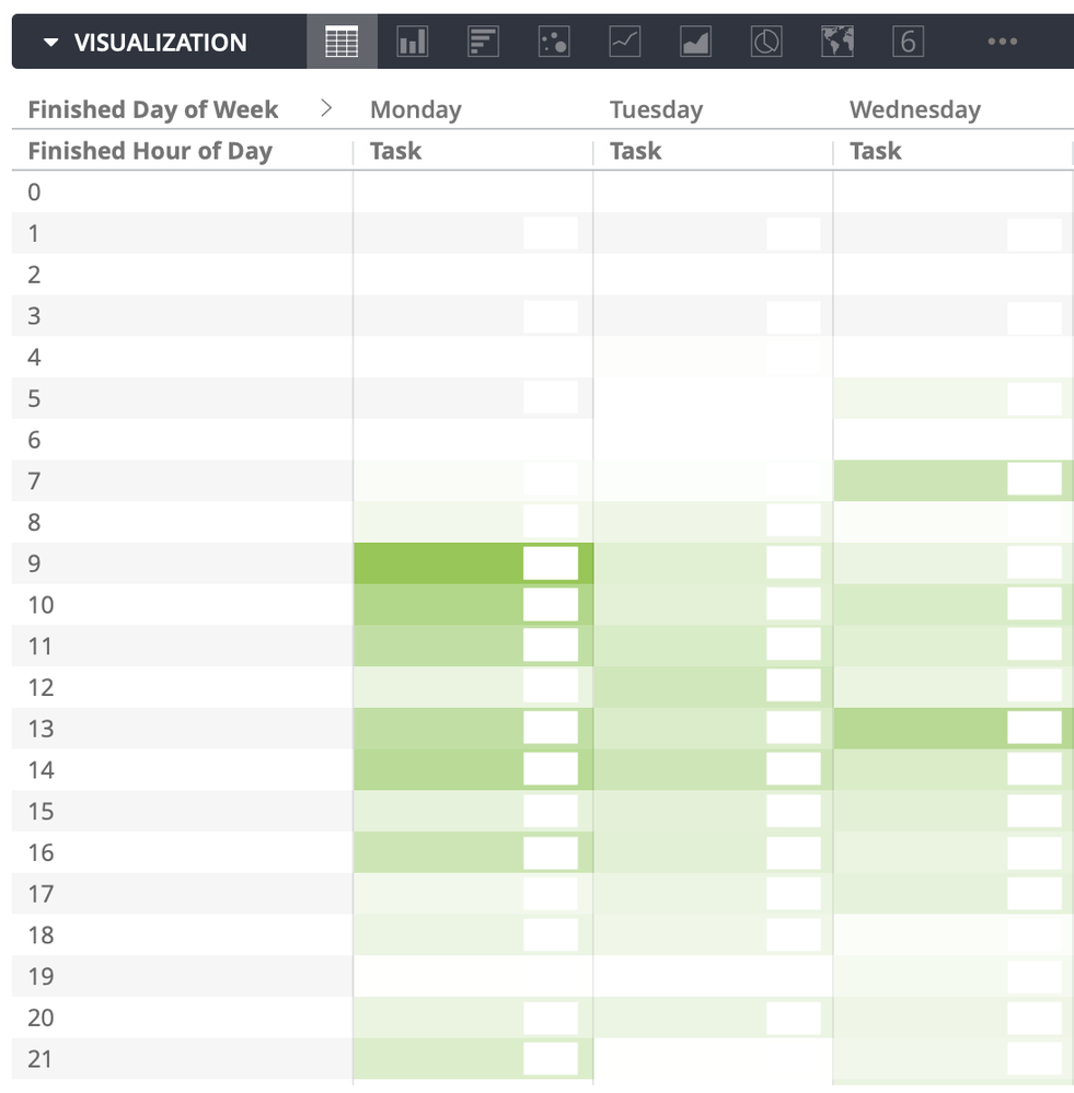

I am facing an interesting challenge: I created a heatmap of production data and want to convert “Hour of Day” from 24-hour into the 12-hour time system.
You can see in the image above that the “Hour of Day” from dimension_group type: time is formatted as the 24-hour clock. I would like to see this in the 12-hour AM/PM format.

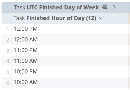

Screenshot 2020-06-13 at 14.46.03

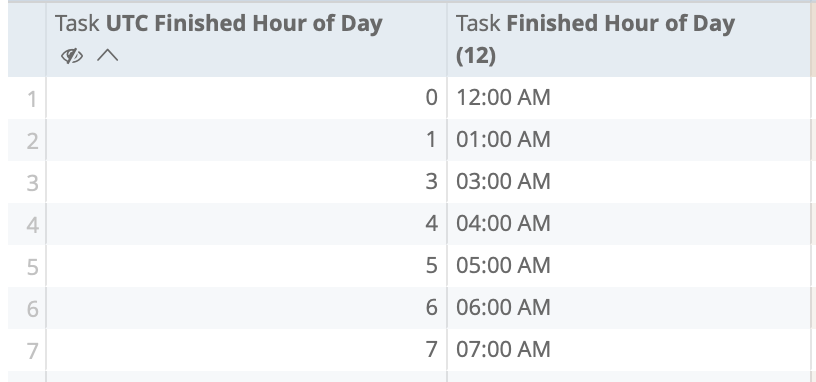

Some problems still remain, for example, as you can see above, the sorting does not work properly. I can fix this by including the “Hour of Day” as a hidden dimension and sorting on that instead.
That brings my second issue, Looker no longer fills missing dates when I add the formatted hour dimension to the query.
Screenshot 2020-06-13 at 14.51.23
