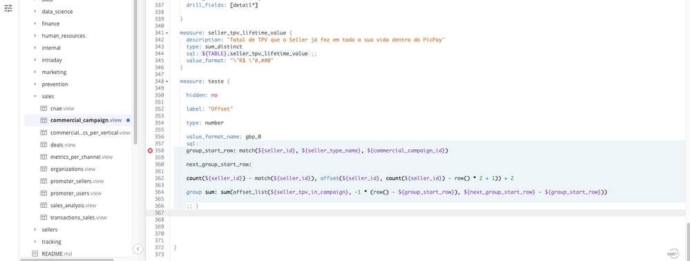

Hi Guys,
I'm really new to the looker environment. I would like to know how I can insert this solution above in this screen that I sent the print? That is my environment.
This solution is exactly something that I really need, but I didn't understand where it is possible to apply these lines of my code.
I thank you for all your help.
Hey @vik_geiling , welcome
You can implement this piece of code on table calculations. Would be something like this:
