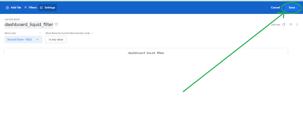

Hi Nstrauss,
Are you saving the changes when editing?
If so, I suggest reviewing the console log of the browser to see if there is any error in background:
To open the developer console window on Chrome, use the keyboard shortcut “Ctrl+Shift+J” (on Windows) or “Option” + “J” (on Mac)
Best,
Leo
Hi Leo,
Thank you for your quick response!  I am saving the changes as I am editing but I have not checked out the console browser; I will give that a go!
Another option is to check the Configure Default Value setting, you have to click a couple of times to edit the filter.
