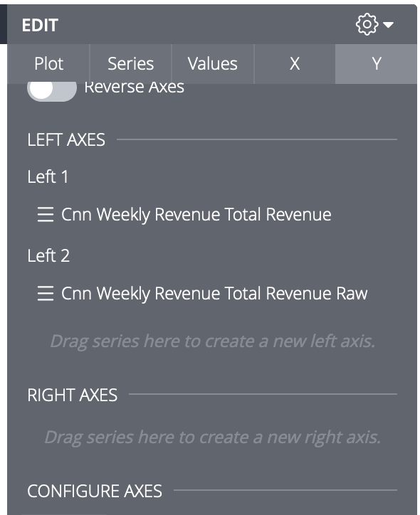

how can i adjust my scales when working with dual axis? I remember in Tableau I was able to synchronize the scale on both sides but can’t seem to find the option here, above solution is not helpful either.
@Cnatlb the answer to adjusting your scales is to move the series to different axis in the Edit window, under the Y tab. Each series displayed can be on its own left or right access. (You can use the scales to overlay series in interesting ways).
