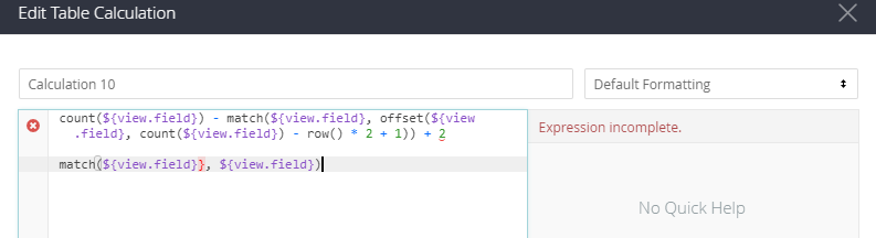

Hi Sara,
I’ve got a similar question to the original poster, however when I try and adapt the code you’ve posted, I get an ‘Expression incomplete’ error and also one of the ‘}’ brackets highlighted in the bottom row to indicate it is not required. I’ve attached an example, albeit without the correct column names for now.
Any help would be greatly appreciated.
Thanks,
Shaun
I’ve not read all the details in this thread, so I don’t know exactly what your formula is supposed to do, but it is obvious to me it is syntactically incorrect. While I don’t know if it will do what you want here, here is revision of your formula that will at least not give an error:
count(${view.field}) - match(${view.field}, offset(${view.field}, count(${view.field}) - row() * 2 + 1)) + 2 + match(${view.field}}, ${view.field})
Hi Quinn,
Appreciate you taking the time to respond and fixing the error in the formula. Happily the formula worked but unfortunately it didn’t achieve what I was hoping it would do. I’ll raise a new thread in regards to this.
Many thanks,
Shaun
