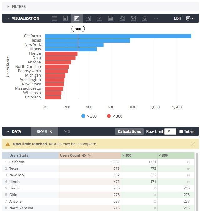

You could potentially use the pattern below, if you don’t have too many buckets.
Imagine I’m looking at user count per state and I want to break out states with 300+ users. Select the dimension & measure and run the query.
Now, create two (or more) table calculations:
if(${users.count} >= 300, ${users.count}, null)
and:
if(${users.count} < 300, ${users.count}, null)
Hide the original measure, and go into viz settings and stack them. This will remove the extra whitespace between the two table calc series. Add a trend line if you like.
The end result should look like this:

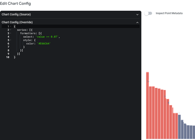

You can use Edit Chart Config for custom formatting.
