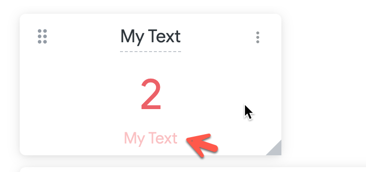

Is there a hack to show the text at the bottom darker than what it shows? i am using a single value look.
Any help is appreciated.
Somehow the title shows opaque with 30-50% transparency i believe, i hope there is an easier way to fix this.
