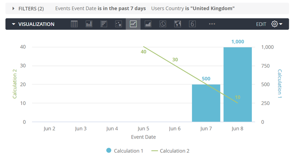

I have a bar and a line chart in one visualisation. I want to hide NULL columns on both but it looks like the setting only work on series that match the visualisation type selected from the vis bar.
This is what it looks like when I have the setting ON, then I turn it off to remove labels and:
The line chart keeps its NULLs : (

Hi Dawid,
I think this should work if you use the line chart graph type from the Vizualisation menu:
And then convert the second chart to a bar chart:

It does, but if I remember correctly from what I tried is that then the bar chart native settings won’t be applied to the bar chart.

I feel this might have been fixed in the latest release, as the null values are hidden by default on bar charts now! 🎊

@Maddie I wanted to point out this isn’t working for me when using a table calculation. Is it supposed to support that as well?
it's possible i think, to set a minimum value for the Y axis to 0,5
in my case, since Y axis shows only integer numbers, it helps me filtering out null values
