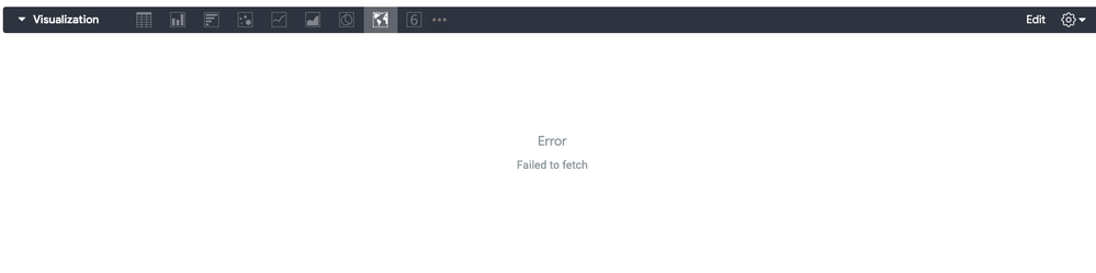

Echo1
Hi @Mintz Thank you so much for sharing it with the community!
I was able to make it work 20 days ago but now I saw “Fetch data error” in Looker.
Is it because mapbox updated their api?
Thanks!
Echo

Echo1
Thank you for the reply! This is what I saw in Looker now :<
Echo1

Ooooh, that’s a new one. If you know how, could you open up the JS console as you load it and see if there are any errors there?
Echo1
Um..I’ve never used JS console in Looker before. Should I follow up these steps to setup?
https://docs.looker.com/reference/embed-sdk/embed-sdk-intro
Ah, sorry, I just meant in Chrome. If you go to View → Developer → JS Console.
Echo1
Kk. I am seeing this (blurred sensitive info)
Access to fetch at 'https://rawcdn.githack.com/***/extents.json' from origin 'https://***.looker.com' has been blocked by CORS policy: No 'Access-Control-Allow-Origin' header is present on the requested resource. If an opaque response serves your needs, set the request's mode to 'no-cors' to fetch the resource with CORS disabled.
Ok, that’s helpful. I’m not sure that’s the issue that’s causing the error message, but it’s definitely interesting. If you have access to chat support, it’d be great if you could ask them so they can file a bug. If you don’t, you can send it in to support@looker.com. Something’s definitely wrong, I’m just not sure yet what it is.
Echo1
Problem solved! Looks like there is something wrong with the
extents_json_url: "https://rawcdn.githack.com/[YOUR_EXTENTS.JSON_FILE_LOCATION]"
I uploaded to Gitst instead of Github and regenerated the url and it worked!
Great to hear it’s solved. I still think it’s a bug though that it wouldn’t display without the extents file. Was this on a dashboard? Doesn’t look like it from your screenshot,  but just want to confirm.
