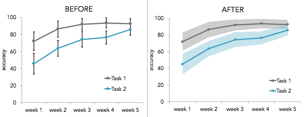

I would like to plot the mean of a given variable, together with a representation of variance, on a monthly basis. I can plot the mean easily using a line plot, but so far could not figure out how to represent the standard deviation in the same line plot. See an example below on the type of visualization I would like to achieve (either error bars or shaded area around the mean).
Is there a way to do this in Looker?

You want to build a time series, that will allow you to add error bars.
There's probably a better option but what I would do is..
Table calculation for mean,
Table calculation using mean to find upper and another to find lower... mean +/- stddev_pop({measure}).
This will give you 3 lines and perhaps it's possible to use area shading to get that going but haven't figure it out yet.
