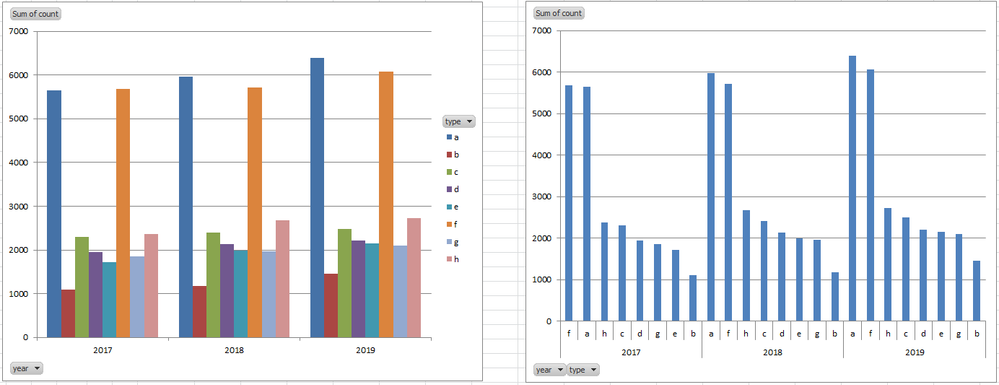

Looking for the ability to perform nested sorting within a visual. This was something I used on a regular basis in Tableau and since my transition to Looker Iโ€™ve had difficulties finding a solution.
An example of this is below, something I did in Excel to try and communicate what I am trying to do. In the image, the chart on the left is what I am currently producing in Looker and the chart on the right is where I want to get to.

How about trying this?
Hold down SHIFT as you click on the column headers in the order you would like them sorted.
For example, here I clicked on Campaign Created Year to get it to order by ascending dates and then held down SHIFT as a I clicked on Count of Product Type.
