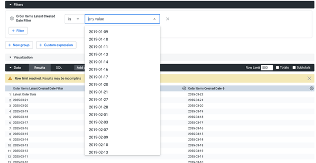

  • Unfortunately Looker filter suggestions sort descending which doesn’t work for us as you can see here:
Step 3: Use a helper dimension to flip the sort and user order_by_field with that helper dimension
  • While there’s no parameter to force filter suggestions to sort ascending, we can just use some clever SQL in a new dimension to convert our dates to numbers in the order we want (And add hidden:yes to not clutter our explore)

  • Finally we change our order_by_field parameter for our latest_created_date_filter field to that date_sorter helper dimension and we are good to go!

  • If you want to create a dashboard from this, just make sure to set the filter on that latest_created_date_filter dimension you created, and lock in the default value for the filter as ‘Latest Order Date’
