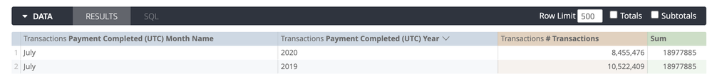

I created a custom filter to calculate transactions in last month and same month last year (year over year analysis).
I would like to calculate difference between those two values and percent change. Is there any way I can add a new table calculation or measure to calculate these values?
I can calculate sum using sum function in table calculation. Want to calculate difference in similar manner.
0 6 9,592
You can! Using table calculations 🙂
Hi @mprogano!
Thank you for your quick response 🙂 This works perfectly fine!
