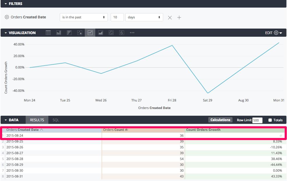

Another good use of this pattern is to remove null values from a visualization which are a product of a table calculation which always returns null for the first row, i.e. percent change or percent of previous.
Here is my visualization and table as is, notice the null value for 2015-08-24:
If I want to remove the Mon 24 point from the vis I can do so by creating a column that returns No when the value is null, and then filtering out the Nos:
NOT is_null(${count_orders_growth})
A similar pattern to this can also be used to filter a measure and still display totals! Check that out here.

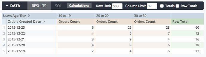

I have a case where I need to show a particular calculation ONLY under the last column. This calc is finding the difference between the last column and the second last column.I am able to create the calc, but this column is visible under the second last column as well. How do I remove the calc from that second last column alone?
Apologies if this is confusing.
Thanks,
Manoj
@Manoj_Pushpanat Are you using pivots? If so, I think you’ll want to use pivot_index in your table calculation to refer to the pivoted columns. This will cause the table calculation to appear on the very right side of the table (as opposed to under each pivot value).
For example, creating a table calculation that subtracts two pivot columns from each other would look something like:
pivot_index(${view.field},2) - pivot_index(${view.field},1)
This will make that table calc appear all the way to the right to look something like this:
We also have more about using pivot index in table calcs here.

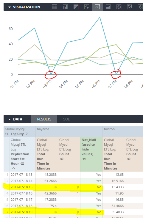

It appears, though, that it doesn’t work when you’ve got pivots involved. I’ve got an explore where some series contain null values at certain points of day, and others don’t. The nulls show as 0’s in the visualization:
When I choose “Hide 'No’s from Visualization”, the visualization just displays “No Results”.
Am I missing anything, or does this just not behave with pivots?
Hey @TimothyBurke,
This feature will work with pivots, but the yesno value has to be outside of the pivots. The reason for this is that the “hide no’s from visualization” option hides an entire row! So if the yesno value is inside the pivot, you could have a “No” AND a “Yes” at the same time.
For your use case it would be much easier to instead turn off the “Plot Null Values” toggle in the Plot section of the visualization settings!
