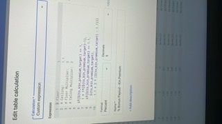

I’m trying to simplify that calculation.
To reduce unnecessary steps in line 7. So instead of having it like the way it is right now, I’m trying to make line 7 into a simple calculation.
Can you paste the whole calculation, I can’t see anything from that screenshot

Want to simplify line 7.
