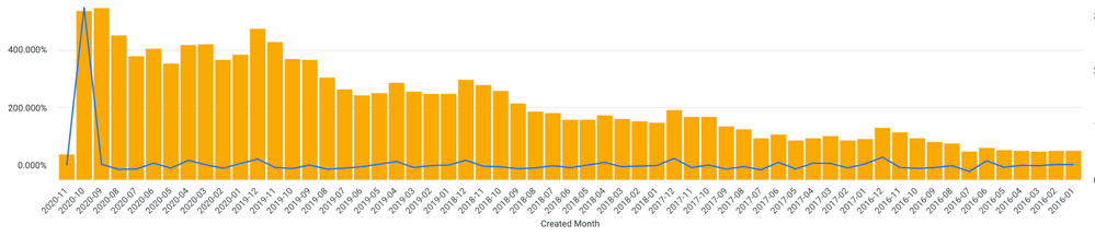

One thing specifically I’d like to see: Churn by # of months subscribed aggregated no matter what month they joined the subscription.

Thanks for the note! For the visualization a common trend is to use our column visualization to show the total number of users (we could group this by number of months since they have signed up) and then, we can go to the series tab and show churn as a percent with a line visualization (We would most likely want to separate these in two axises so the percent is easier to see).
We could also show another column for revenue by cohort. This article shows us some more details on how to implement this. For your specific use-case, we could potentially use a duration dimension_group type with a start date and end date. This should give us the number of months (or other timeframes) since they signed up.
