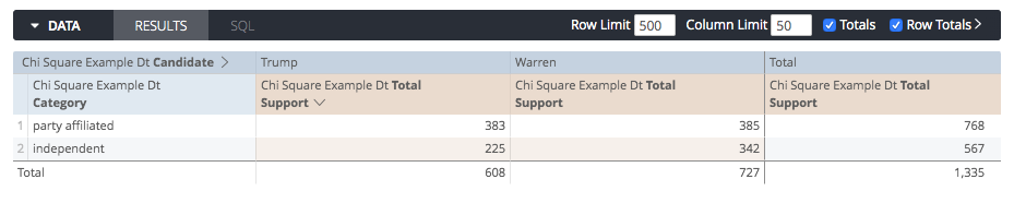

Step 1: Get our data in a 2x2 table
I’ve selected my first dimension (Category), pivoted my second dimension (Candidate) and added my Total Support measure. I’ve also checked the Totals and Row Totals checkboxes. The result is this:

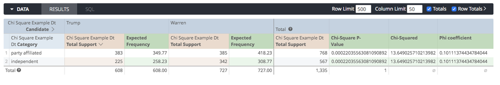

Step 2: Estimate the expected frequency
Now that we have our actuals, we need to calculate their expected frequency which, for any cell, is estimated as (row total * column total) / grand total.
We’ll create a first table calc named Expected Frequency with a Decimals (2) format and the following expression:
(${chi_square_example_dt.total_support:row_total} * ${chi_square_example_dt.total_support:total})
sum(pivot_row(${chi_square_example_dt.total_support:total}))
We now get this output:
Step 3: Calculate the probability (or p-value):
Now that we have our actuals and expected values, we can now calculate the p-value.
We’ll create a second table calc named Chi-Square P-Value which will use the chisq_test function. The description of the function is:
“Returns the probability for the chi-squared test for independence between actual and expected data. actual can be a column or a column of lists, and expected must be the same type.”.
Since we’re dealing with a 2x2 Contingency, we’ll nest the pivot_row function within the chisq_test function a first time to return a list of the values of each candidate’s actual values, and a second time to return a list of the values of each candidate’s expected values:
chisq_test(
  pivot_row(${chi_square_example_dt.total_support}),
  pivot_row(${expected_frequency})
Step 4: Calculate the Chi-Squared (or χ2 )
Now that we have our p-value, we can calculate the Chi-Squared by using the chisq_inv function. The description states:
“Returns the position of probability on the inverse cumulative gamma distribution with dof degrees of freedom” .
For this function, we need to know the degrees of freedom. The formula for this is pretty simple as
dof = (number of rows - 1) * (number of columns - 1)
So (2-1) * (2-1) = 1. We’ll create a third table calc named Chi-Squared with the following expression:
chisq_inv(1-${chi_square_p_value}, 1)
Note: We’re substracting the p-value from 1 since the p-value measures the “tail” and the inverse function measures the “head”.
We now get this as an output:
So there you go! The same principle would apply here for a bigger contingency table.
Step 5: Phi Coefficient
Let’s add the Phi Coefficient now. The formula is once again pretty simple:
√ (Chi-Squared / grand total).
Let’s create a table calc named Phi Coefficient with the following expression:
sqrt(${chi_squared}/sum(pivot_row(${chi_square_example_dt.total_support:total})))
Our output is now:
Step 6: Percentage of Voters
Let’s add a final, easy calculation to help us write our conclusion: let’s add the percentage of voters for each category. The expression for this additional table calc formatted as Percent (1) would be:
${chi_square_example_dt.total_support} / sum(${chi_square_example_dt.total_support})
Which gives us our final output:
