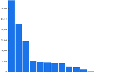

I need tips for 2 visualisation requests:
1) I want to keep a short dash extending from the y-axis values, without having the gridlines running through the entire chart. Is there a quick solution for this?
2) I wish the max y-axis value to be always above the max value of any bar value. In the viz settings a max y-axis value can be set, but that would disable auto-scaling. Is there a way to let it auto-adjust the top y-axis value to always cover the max bar value?

1) Is this the image you are assuming?
If so, You can do this by clicking the Custom button at the bottom right in the Visualization section of the Explore screen and overriding the following code. (It takes a bit of work. If you don't know how to do it, I'll explain it to you.)
  ,yAxis: [{
    gridLineWidth: 0,
    tickLength: -5,
    tickWidth: 3,
    zIndex: 10
I can't immediately answer 2), so for now I'll just reply to 1).

Regarding 1), do you want it to look like this image?
It takes a bit of work, but it can be achieved by changing the graph configuration.
https://cloud.google.com/looker/docs/chart-config-editor
  yAxis: [{
    gridLineWidth: 0,
    tickLength: -5,
    tickWidth: 3,
    zIndex: 10
If you don't know the detailed steps, I will tell you.

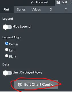

Thank you so much @tanakakentaro ! Yes this is what I wanted for point 1! May I check if the Chart Config Editor feature needs to be enabled in order to access this? I currently do not see this button in my visualization settings.
(pic taken from online)
Thanks!
Unfortunately, it seems you likely won't be able to use it unless 'can_override_vis_config' is enabled by your administrator.
If you really want to use it, I recommend that you consult with the administrator.
https://cloud.google.com/looker/docs/chart-config-editor#prerequisites
Hi @tanakakentaro. My Looker admin enabled this permission for me. It worked well! Thanks a lot!
