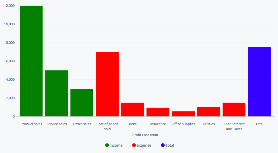

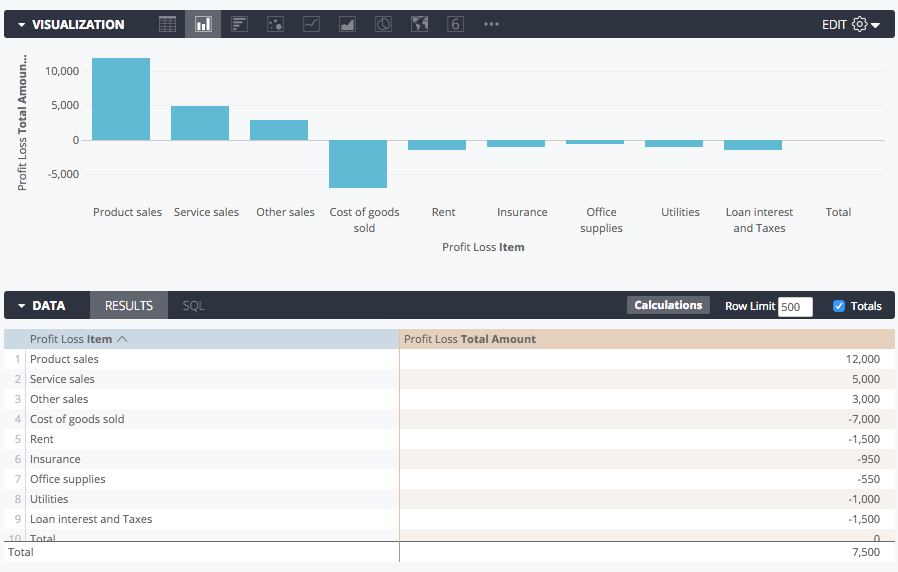

My explore at first is not very waterfall like. Note: I’ve turned on my totals, we will get to this in the next step.
Then the explore will require some new calculated fields. In my example I just want green for income, red for expense, and a total bar. First, I create those as calculated columns:
Income: if(${profit_loss.total_amount}>=0,${profit_loss.total_amount},0)
Expenses: if(${profit_loss.total_amount}<0,-${profit_loss.total_amount},0)
Total: if(${profit_loss.item}="Total",${profit_loss.total_amount:total},0)

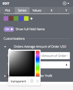

Then I set their colors in the ‘Series’ tab of the visualizaiton settings.
(In pre-series tab versions of Looker, you can change this by specifying the colors you want in the “series colors” box of the style tab, like expense: red )

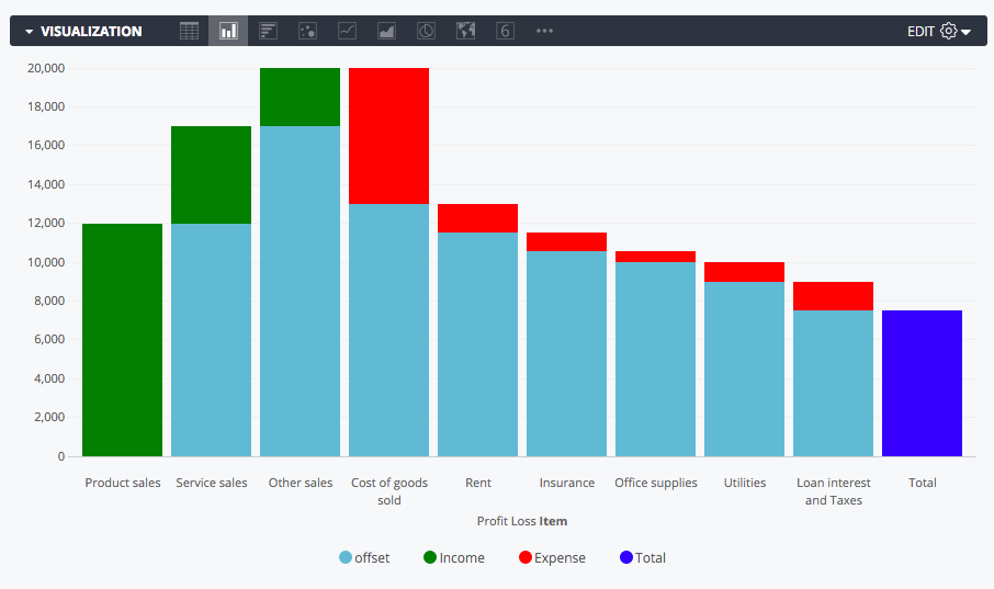

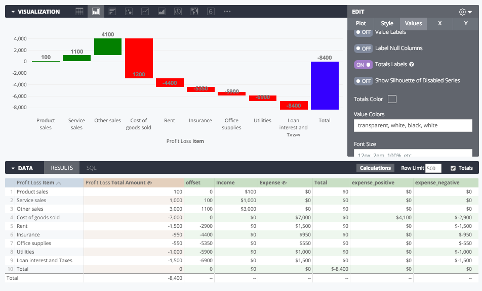

Now I need to add an offset to bump up each bar by its previous bars. I use two functions: running_total() and offset(). Offset lets me use the previous income line, and the rest I just subtract so the bottoms of the expense and total bars line up.
Offset: running_total(offset(${income},-1)-${expense}-${total})
Now my chart looks something like this:
The data table should have any measures hidden outside of our calculated columns.
I just need to set my offset to “transparent” so that we don’t see it. Click on the color you would like to change in the Series tab, and type ‘transparent’ into the text box.
(Pre-color picker: just add offset: transparent to the style box in the visualization settings. )
You can even pass the transparency to the value labels. I used transparent, white, black, white for this. Check out the final product!

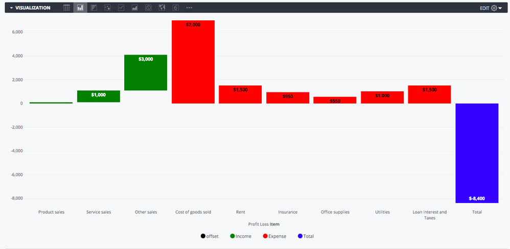

What if the running total results in a value less than zero. I think your calculations need a revision.
You are right, what if we run a loss?
The method above would end up looking like this:
Not so great!
To fix this I broke up my expense column into two columns: a positive and a negative. It’s not super pretty, but it works.
Here are my new calculations
expense_positive
if(${profit_loss.total_amount}<0,if(offset(running_total(${income}-${expense})>0,-1),offset(running_total(${income}-${expense}),-1),0),0)
expense_negative
if(${profit_loss.item}="Total",0,${expense_positive}-${expense})
I also had to modify my offset calculation and hide my existing expense calculation
offset
running_total(offset(${income},-1)-${expense_positive}-${total})+running_total(offset(${expense_negative},-1))
Then, instead of value labels I added our new totals to each stack. You can read about those here and in our 3.42 release notes.
This can be cleaned up a bit, depending on your use the same method may need to be put into the income calculations, however I always keep those first.

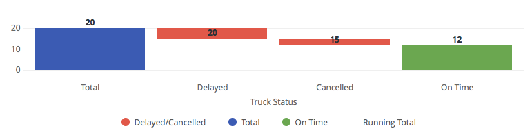

Hi Tomas!
The best to do this would be to restructure your data so we can add a totals row to the results. Ideally your data should be structured as follows:
Truckstatus Count
On Time     12
Delayed     5
Cancelled   3
Total       20
This can be done in a few ways, depending on how your data is structured in your table. One option would be to create a derived table where we union with a total count:
SELECT
  truck_status,
  COUNT(*) AS amount
FROM table
GROUP BY 1
UNION ALL
SELECT
  “Total”,
  COUNT(*) AS amount
GROUP BY 1
To make sure we order the truck_status from Total to On Time, we can add an extra dimension on the LookML side, that defines the ordering:
dimension: truck_status_order {
    type: number
    sql: CASE WHEN ${TABLE}.truck_status = "Total" THEN 1
    WHEN ${TABLE}.truck_status = "Delayed" THEN 2
    WHEN ${TABLE}.truck_status = "Cancelled" THEN 3
    WHEN ${TABLE}.truck_status = "On Time" THEN 4
    END;;
Once we’re done with this we can start building our waterfall chart. Just like in the original example, we’ll create some additional columns using table calculations. For this example we’ll create the following:
Total: if((${text.truck_status} = "Total"),${text.count},0)
Delayed/Cancelled: if((${text.truck_status} = "Delayed" OR ${text.truck_status} = "Cancelled"),${text.count},0)
On Time: if((${text.truck_status} = "On Time"),${text.count},0)
We’ll create the running total as well, although this one is a little bit different from the original example. This is because we’re starting with the total instead of ending with it. Don’t forget to enable Totals on the table.
if(${text.truck_status} = "On Time", 0,running_total(offset(${total}, -1)-${delayedcancelled}-${total}))
Just like in the original example we’ll make the running total value transparent in the visualisation. And add some color to the visualisation. The end result looks like this:

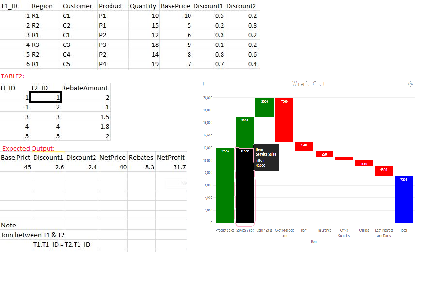

Hi, this chart looks great. Needs some more information from you:
For us we are getting the attributes from more than one table and it’s not row level but in columnar attributes to calculate waterfall chart.
So how to put these tables together and create waterfall chart and also we should be able to filter data based on different attributes
One more question regarding the UI prespective:
While mouse hovering on the bar we are still able to see the Offset values, how we can disable the offset visualization while mouse-hovering. Attached image has highlighted :
Please let me know if any concern.
