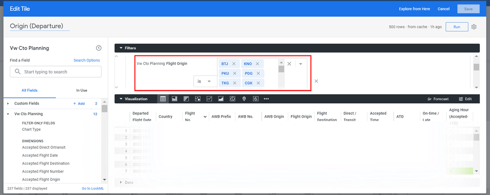

Why the filter by field in the table does not work?
I tried to filter the table using the filter by field as below. If filter by this alone, the data shows as filtered.
But when I saved this table and look it in the dashboard. The filter by field does not work and show the information that I don't want to show as below.
I'm not sure is it because of the filter on top (yellow box) that affect it or not.
Is there anyway that I can keep the filter in the table, but still use filter on the top (yellow box) at the same time without this kind of error?
Thanks in advance.
