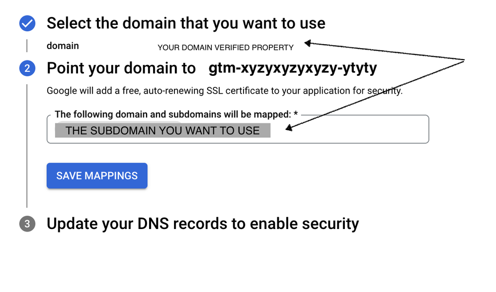

You can get around this by selecting the domain verified property and then removing the root domain and others from the mappings offered and adding your subdomainScreenshot 2024-02-19 at 16.15.16.png
