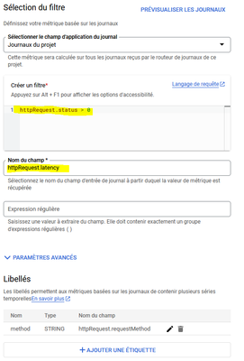

I'm currently doing a study project where I'm assigned to do Monitoring.
I've followed this tutorial to help begin and build my first dashboard.
But when I'm trying to visualize information in the dashboard, I never see the information working.
The "no data" pic :
My custom metric :
The kind of logs I'm trying to measure :

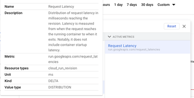

Thank's for writing here. Basically, your screenshots presents [1]log-based metrics , not [2]custom metrics or user-defined metrics ( those names can together) . Your configuration is partially okay, however, under the filter field, you should specify filtr for logs [3] . So you must combine [4]query and based on that query create log-based metric and alert. Examples can be found at Google's documentation. Apart from that, if you are trying monitor https latency for cloud run, wouldn't be better to use [6]metric provided by Google?
[1] https://cloud.google.com/logging/docs/logs-based-metrics
[2] https://cloud.google.com/monitoring/custom-metrics#:~:text=User%2Ddefined%20metrics%20are%20sometime....
[4] https://cloud.google.com/logging/docs/view/logging-query-language
[5] https://cloud.google.com/logging/docs/view/query-library
[6]

Additionally,
I've made simple cloud run revision,  and provided few queries for cloud run, [1]httpsRequest status code, [2]latency less than value_in_sec
[1]
resource.type = "cloud_run_revision" AND
log_name="projects/product-pages-prod/logs/run.googleapis.com%2Frequests" AND
httpRequest.status="200"
 [2]
httpRequest.latency > 0.005744282s

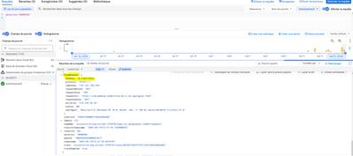

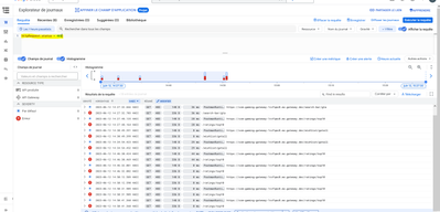

From these logs :
I'm trying to find an MQL query that would build a line chart
I'd like this query to have in axis X the time with an hour or a minute interval and in axis Y, the number of 403 status codes retrieved for the X hour.
I have checked the documentation but I'm struggling a lot building this query...
