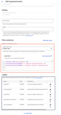

Hello guys,
I use cloud alert and slack to receive nodifications.
I would like to receive the jsonPayload.message field in Slack, but I don't know how to configure this extraction,
Would anyone know?
In the print below, you can see how the data is in cloud loggin.

There is no ( at least known by me ) option to print exact json payload taken from Stackdriver. You can use values from payload by configuring log0based metrics and labels, and log-based alerts and documentation section.
1. Create log-based metric and define labels[1]
2. Create log-based alert from metric[2]
3. At alerting policy, use "Documentation" section to obtain values from metric[3, step 7]
4. Logs will be collected AFTER creation log-based alerts.
[1]. https://cloud.google.com/logging/docs/logs-based-metrics/counter-metrics
https://cloud.google.com/logging/docs/logs-based-metrics/labels
[2]. https://cloud.google.com/logging/docs/alerting/log-based-alerts
[3, step 7]. https://cloud.google.com/monitoring/alerts/using-alerting-ui#preview
