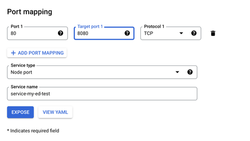

My question is adding new rules in GKE Ingress won't auto-connect to the load balance backend, but strangely, all related resources all be auto-created success. Here's the workflow:
Step 1, create a new deployment and make sure it is alive
Step 2, expose the deployment as NodePort
Step 3, add this Service to an existing Ingress

Hi @jamesaaron  , here's the YML config
(BTW we're using GKE to provider our SaaS service, we will create 1 Deployment for 1 tenant, and the Deployment will have 1 NodePort Service, and multiply Services will share 1 Ingress with different rules)
For example, we have a tenant with ID 4u5z93wr,
The deployment YML for the tenant:

The service YML for the tenant:
apiVersion: v1
kind: Service
metadata:
  annotations:
    cloud.google.com/neg: '{"ingress":true}'
    cloud.google.com/neg-status: '{"network_endpoint_groups":{"80":"k8s1-74c3cd43-default-service-4u5z93wr-80-3cf1182c"},"zones":["us-central1-a","us-central1-b"]}'
  creationTimestamp: "2023-03-18T07:55:15Z"
  labels:
    tenant: 4u5z93wr
spec:
  clusterIP: 10.12.131.57
  clusterIPs:
  - 10.12.131.57
  externalTrafficPolicy: Cluster
  internalTrafficPolicy: Cluster
  ipFamilies:
  - IPv4
  ipFamilyPolicy: SingleStack
  ports:
  - nodePort: 30326
    port: 80
    protocol: TCP
    targetPort: 8080
  selector:
    app: 4u5z93wr
  sessionAffinity: None
  type: NodePort
status:
  loadBalancer: {}
And the Ingress config:
apiVersion: networking.k8s.io/v1
kind: Ingress
metadata:
  annotations:
    kubernetes.io/ingress.global-static-ip-name: bytebase-ip-01
  namespace: default
spec:
  rules:
  - host: 4u5z93wr.us-central1.bytebase.com # for tenant 4u5z93wr
    http:
      paths:
      - backend:
          service:
            port:
              number: 80
        pathType: ImplementationSpecific
  - host: 94xbo23h.us-central1.bytebase.com # for another tenant
    http:
      paths:
      - backend:
          service:
            port:
              number: 80
  # and many other rules for different tenant
  tls:
  - secretName: bytebase-ssl-01
status:
  loadBalancer:
    ingress:
    - ip: xxx
