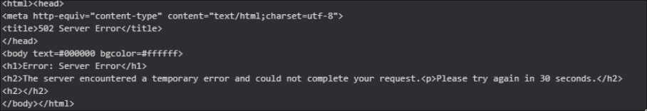

I get the following error upon request and my pod health status in the ingress controller is always returning unhealthy:
20230406_11h00m24s_grim.pngThese are the only two errors I am getting.

Hi @jrw ,
Based from the app.yaml that you have shared, you are getting this issue because you don't have the health check configured for your service. To resolve this issue you need to have a health check for your backends because load balancer verifies if the backends are in a healthy state or not. I suggest you create a "BackendConfig" for health check using this guide. After creating the health check configuration "BackendConfig" add the annotation below in the service yaml file.
cloud.google.com/backend-config: '{"default": "my-backendconfig"}
