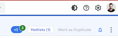

TLDR; Known issue with large volume of misleading logs originating from gke-metadata-server.  See https://issuetracker.google.com/issues/297084117
If you are running into this issue, please go to the issue tracker link and click the vote impacted button (its the +1).

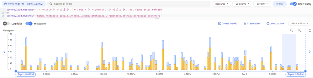

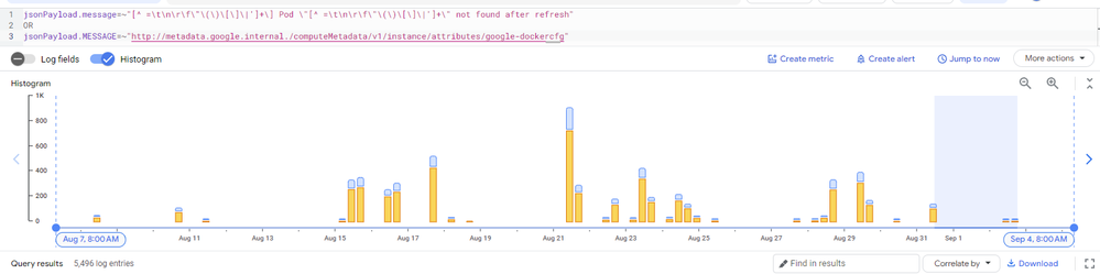

On our test project, I found one of the first nodes to have started with these errors had this log roughly 3.5 seconds before the Pod not found after refresh logs began en mass.
I'm not sure if this is just coincidence or side effect from the same issue (pods starting up or something?)  but I made a Log query to find all the warning logs saying Pod 'xyz' not found after refresh and then found all the logs that contained the URL with the period in it and interestingly enough (for me at the moment) there almost always seems to be the Pod 'xyz' not found after refresh (warning, yellow) messages in near proximity to the `Failed to read URL` (notice, blue) messages:
Here is another picture of the histogram without the most recent surge on the 4th of Sept:ethansq_1-1694022850222.pngProduction Projectethansq_2-1694023599963.png
Query used for these pictures:
jsonPayload.message=~"[^ =\t\n\r\f\"\(\)\[\]\|']+\] Pod \"[^ =\t\n\r\f\"\(\)\[\]\|']+\" not found after refresh"
OR
jsonPayload.MESSAGE=~"http://metadata.google.internal./computeMetadata/v1/instance/attributes/google-dockercfg"

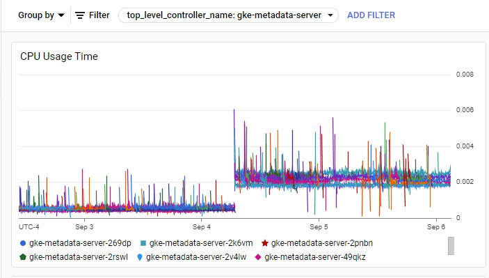

CPU Usage for gke-metadata-server, can see all pods dropped off and all the new ones are using more CPU. No other workloads indicate this.

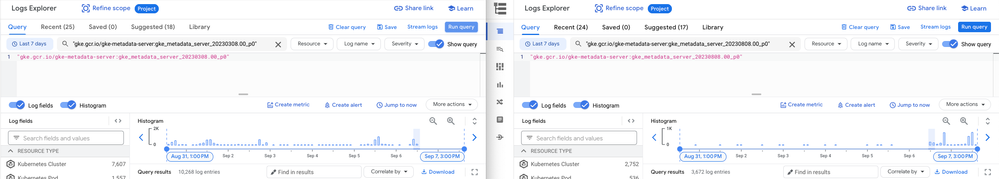

Image change for gke-metadata-server workload lines up with increased logs
previous image:
gke.gcr.io/gke-metadata-server:gke_metadata_server_20230308.00_p0@sha256:c6116d0b53bb58bfebb661a5aaaf18835d64b3db8a99b59a5556cee76277fb9e
current image:
gke.gcr.io/gke-metadata-server:gke_metadata_server_20230808.00_p0@sha256:c64b779853dfa571d5583df91fe77dde18b6e0b465df58077f6422bd8edc99e3

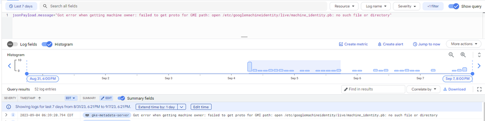

I also spotted this log which doesn't appear to exist prior to this image
jsonPayload.message="Got error when getting machine owner: failed to get proto for GMI path: open /etc/googlemachineidentity/live/machine_identity.pb: no such file or directory"
I'm seeing a similar issue-- same error message. Started happening yesterday, 9/6. I'm on the same GKE version and gke-metadata-server is on gke.gcr.io/gke-metadata-server:gke_metadata_server_20230808.00_p0 as well.
image (7).pngSame deal-- the gke-metadata-server image upgrade from 20230308 to 20230808 coincides with the timing of the issue.
