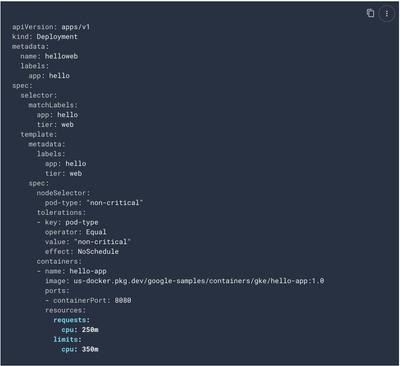

Can you share your deployment spec?
Sure. I just use the example in the doc: https://cloud.google.com/kubernetes-engine/docs/how-to/pod-bursting-gke#deploy-burstable-workload
apiVersion: apps/v1
kind: Deployment
metadata:
  labels:
    app: hello
spec:
  selector:
    matchLabels:
      app: hello
      tier: web
  template:
    metadata:
      labels:
        app: hello
        tier: web
    spec:
      nodeSelector:
        pod-type: "non-critical"
      tolerations:
      - key: pod-type
        operator: Equal
        value: "non-critical"
        effect: NoSchedule
      containers:
      - name: hello-app
        image: us-docker.pkg.dev/google-samples/containers/gke/hello-app:1.0
        ports:
        - containerPort: 8080
        resources:
          requests:
            cpu: 250m
          limits:
            cpu: 350m

Wdym by the cpu and memory limits aren't respected? Did it adjust your limits to be equal to requests? Could you post the modified manifest?
Yes, as soon as I deploy the pod (copied from the URL), I get Autopilot Mutator Warning that the CPU resources have been adjusted to meet minimum requirements.
Here's the pod it creates: https://gist.github.com/thesrs02/b4ebbce82340d82b140db2595bf3b840
Hey, I gave this a go and confirmed. If I manually adjust the request to `500m` and set the limit to a higher value like `750m` it works as expected. I'll check if there's an explanation and get back to you
I'm trying to set it to 50m or 250m, not 500m. I know it won't throw a warning on 500m.
I get that, still needed to check to be sure
It seems to have resolved on its own for some reason. Quick question, by default, will every pod be a burstable class?
Only if your limits are different to your requests. If you explicitly set requests == limits, they'll be Guaranteed QoS.
https://cloud.google.com/kubernetes-engine/docs/concepts/autopilot-resource-requests#resource-limits
But that's weird that it resolved itself, did you do anything differently to the first time?
No, nothing at all. Was waiting for updates here.
@rehan2 so the defaulting happened because the workload in the doc had a nodeSelector and a toleration, which means that it uses workload separation. Autopilot enforces higher minimums (500m CPU) for workload separation (see https://cloud.google.com/kubernetes-engine/docs/concepts/autopilot-resource-requests#workload-separa...). So it was working as intended. We'll update the doc to remove that from the manifest, since the example Pod's requests are <500m CPU.
@rehan2 just closing it off here, updated https://cloud.google.com/kubernetes-engine/docs/how-to/pod-bursting-gke#deploy-burstable-workload so that the manifest doesnt use workload separation
