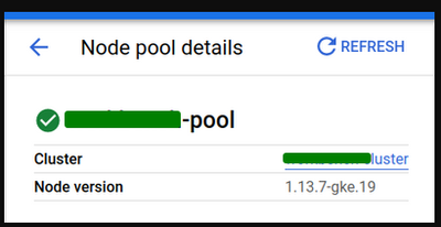

Our GKE cluster is created as standard (no autopilot) and the versions are
As said before it was working fine regardless of the warning about the versions. However, we haven't been able yet to identify what could have changed between the last time it worked, and now.

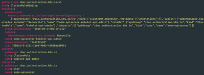

Thanks for your quick response @dionv !
We have a similar cluster Role Binding  object which seems similar to the one you mentioned
even though we created a new one as suggested, however we have same issues trying to interact with the cluster.
in the docs it says it must be ensured the cluster uses the --kubelet-client-certificate and --kubelet-client-key flags for auth. I'm not entirely sure how to check this our GKE cluster
I found this troubleshooting point in the docs. as well, we'll explore a bit more on that path
