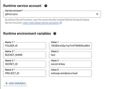

7. Create Cloud Function. If you get question about API , click Enable APIs.
8. Name your function -> Allow unauthenticated invocations ( only for testing !)
9. Choose your service account created at the beginning as "Runtime service account"

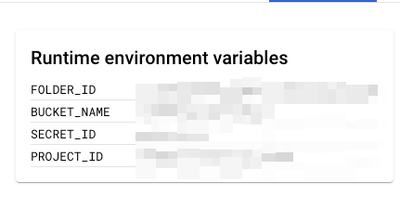

10. Add Runtime Variables with values
FOLDER_ID = FOlder ID taken from Google Drive
BUCKET_NAME = name of the bucket where files will be copy/pasted
SECRET_ID = name of secret, under where you keeping ServiceAccount Key content
PROJECT_ID = ID of the project where cloud function will be created
EXAMPLE:
