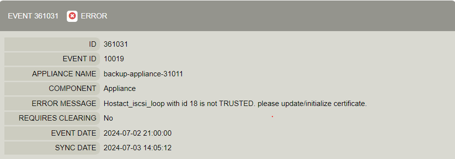

Once per day getting event id 10019 with description "Hostact_iscsi_loop with id 18 is not TRUSTED. please update/initialize certificate." Doesn't seem to be anything in documentation about this error. Any way resolve?

Warning / Error - Event ID: 10019
Error Message: Hostact_iscsi_loop with id 18 is not TRUSTED. please update/initialize certificate.

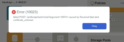

Thank you for your answer, but when trying to follow your instructions a certificate error prevents to access the "edit host" page:
Also, how would I know where the `udsagent` binary is installed? We never installed an agent, we are relying on disk snapshots and the base idea I got from the tutorial videos was that no action was needed on the host itself, as the system performed disk snapshots through the GCE API
