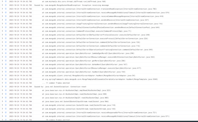

I noticed that since October 18, the tasks I run on top of Batch will regularly fail due to the network, but if I run them on GKE, there will be no problem with the tasks, I don't know what is causing this? it was failing to connect to mongodb. Is there any upgrade done to the Batch service?

job UID:  ifr-etl-2572084247-f7e92d19-a6c1-4a1d0、ifr-etl-2572734806-3e59fe2b-fbb7-4b0a0
