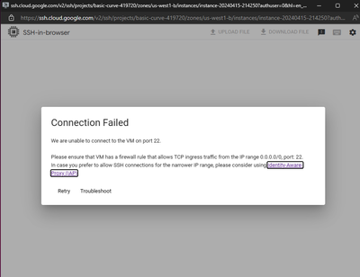

Here in below i shared two comments with you, thanks in advance for help
I can not connect VM, have can i check in my VM if SSH enabled ? Which is enabled i am pretty sure because i have never disabled or do something on vm
I do not use api
Normally till 2 days ago, i was able to connect via external IP ssh and web gui methods
all ports are enabled
Here is the error that i got

i think something is wrong with my compute enginer, as you see in my previous command Cloud IAP is not enable but still when i try to login via ssh it tries to use Cloud IAP
When i click on "retry without Cloud IAP", this happens
troubleshoot
Hi, it seems you try to connect to your vm through ssh console, if your vm don't have  external ip so you have to login with IAP proxy. make sure you enable the IAP Api and more important to set the iap source ip firewall in your vpc,
you may read the doc about
https://cloud.google.com/iap/docs/using-tcp-forwarding
My machine has external ip address. IAP is disabled and i dont use it, that is the problem why my machine uses IAP even though it is disabled. Secondly i also enabled and configured firewall rule for the IAP source net, but it is always same.
