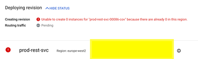

[Cloud Run] Unable to create 0 instances because there are already 0 in this region
When we try to update a cloud run instance we are getting the following error: Unable to create 0 instances for "" because there are already 0 in this region.
Our quotas is 0 for cloud run instance and 2 out of 10 for compute engine. If we deploy to another region we don't have the following problem.

Hi @albertoabruzzo,
The error message indicates that there are no instances of the Cloud Run service currently running in the specified region, and your quota for Cloud Run instances in that region is 0. To deploy your Cloud Run service to that region, you need to increase your quota for Cloud Run instances in that region by submitting a request through the Cloud Console Quotas page. Alternatively, you can also deploy your Cloud Run service to a different region where you have sufficient quota available.
If you want to deploy your Cloud Run service to that region, you will need to increase your quota for Cloud Run instances in that region. To do this, you can follow the steps below:
  1. Go to the Cloud Console Quotas page
  2. Select the project for which you want to increase the quota.
  3. Use the filter to find the "Cloud Run (fully managed) CPU quota" and click on it.
  4. Click on "Edit Quotas" and fill out the form with the desired quota increase request.
  5. Submit the request.
Once your quota increase request is approved, you should be able to deploy your Cloud Run service to that region without any issues.
This suggestion is not at all helpful.
Even our team is facing this issue.
What's the proper solution?
