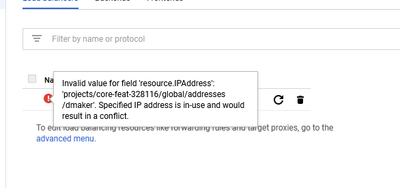

I have setup sucessfully some minutes ago a load balancer with a static IP address which I created on the process.
Then I had to delete it and create it again because I forgot to enabable the redirection from http to https.
Now, when I try to createagain the load balancer I get an error saying the following:
Invalid value for field 'resource.IPAddress': 'projects/core-feat-328116/global/addresses/dmaker'. Specified IP address is in-use and would result in a conflict.

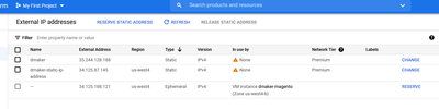

And when I go to the external IP address section, this IP I created apeears as "In use by None".
I've already tried creating the IP fro this window and then just ssigning it on the process of creatig the load balancer, but for some reason it doesn't even sho up in the list of static ip addresses.
I've also tried deleting all these IP's and doing the process all over again, but I still get the same message.
