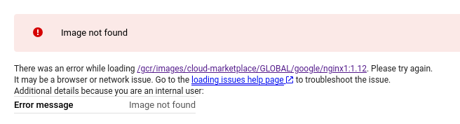

Based on the logs, there might be an issue pulling the image from Google Container Registry (GCR). We can verify this by navigating to the container image link.
As you can see from the image below, the image nginx 1:12 doesn't exist.
To answer your question, the document is outdated. As of September 22, 2023, the latest image of nginx that you can use is:
gcr.io/cloud-marketplace/google/nginx1:1.25
I successfully recreated the VM with this image version.
Let me know if you encounter any issues.
