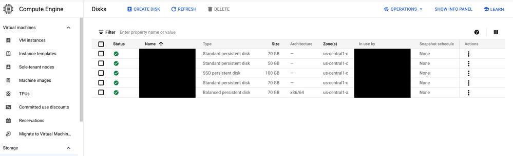

Anytime 🙂 Local ssd disks are used by the VMs, you can check how many local SSD disks are needed for your job's machine type here.
@Wen_gcp Hi! Could you help me please? I have increased Quota for SSD (now it should be 1TB) and as a result - this Quota got a limit value. Before I increased the limit was 500 and the value jumped to 394, now the limit is 1TB and the value has increased to 984GB.
How can you find out where to spend it? I have 1 VM and it uses 40GB, but where did the rest go?
I could be wrong, but it looks like this: The instance tries to start, allocates resources (SSD, etc.) and when it reaches some resource, it receives an error because there is no free one.
But at the same time, the SSD remains marked as in use.
I increased the limit to 4TB but the errors are exactly the same 🙂

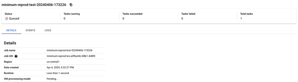

Hi @Wen_gcp, thanks for getting back to me on this.
I have put together a minimal reproducible example based on the example job definition in the documentation.
Here is the job definition:

Using this test batch job to answer your questions:
    1. UUID: minimal-reprod-ssd-822f2967-bf0a-4ccd0
    2. Region: us-central1
  1. This is the (partially redacted) output from running
gcloud batch jobs describe minimal-reprod-ssd-allocation-20240401-141753 --location us-central1

I have attached three images that show
  1. The entire SSD quota (16 TB) being consumed quickly after the job is submitted.
  2. The disks page of compute engine, showing that no significant SSD usage exists.
  3. The job page showing that this job was in the queued state when the other two screenshots were taken.
I'm thinking the quota check must be putting some type of hold on the SSD quota (which appears as real consumption). I am guessing this was done to avoid a race condition where two different jobs could pass the quota check at the same time and result in double quota use. The job UUID for this new job can be seen in the third image if you require it again.
Thank you

Thanks for the information @echap! The quota check is purely a read on quota status of the project and won't hold quotas. I am not sure if this could happen due to zonal stock out, let me ask around and get back to you, thanks!
