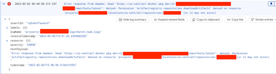

2. Error messages
The Artifact Registry error is bizarre as I've made nearly 1000 batch jobs on different machine types which utilize Docker Images stored in Artifact Registry before.
