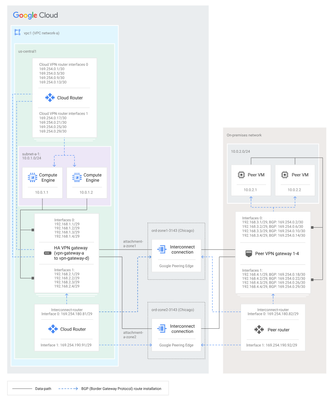

Hi @Thomasaw
Here a diagram that shows the flow:
Check also the deployment steps and configuration to have a better understanding.
If you have a more specific question let me know.
