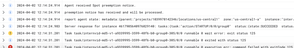

Sure. I'm running the job in us-central1 (not sure if zone is us-central-1a, or multiple zones), and the UID is "internvid-md5-v1-a9339995-3599-48f6-b0".
One issue is, I think the 125 is because of a spot pre-emption notice, but from reading the docs, batch tasks should exit with 50001 following spot pre-emption. For now, I can configure the VMs to retry on exit code 125, but I wonder if I'm hiding a deeper bug.
This is log results from filtering on a hostname:  you can see there's a spot pre-emption notice, and then the runnable exits with code 125.

Hi @vedantroy-genmo,
Yes you find the proper info. And with the job and task information you provide, I checked that your task is failed due to spot preemption.
I would assume if you do Get Task API call for that task `internvid-md5-v1-a9339995-3599-48f6-b0-group0-305` in the snapshot, you should be able to see the task's status event with error code 50001 as
In gcloud, it would be as `gcloud batch tasks describe {YOUR_FULL_TASK_NAME}`.
